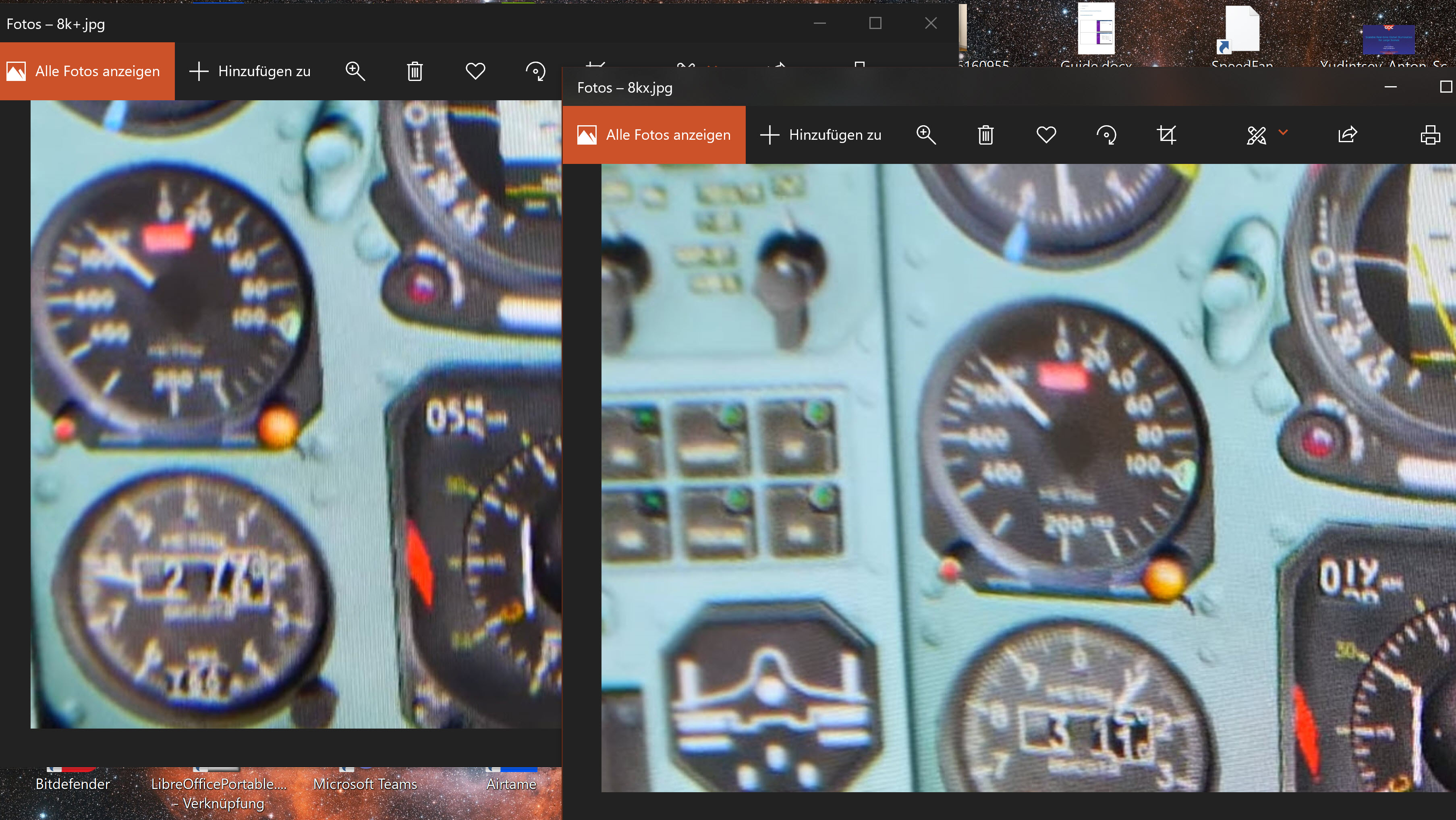

Edit: and a fast side by side, note its done quicke and dirty with screenshots at 4k from Martins Videos, taking the images like that and saving in jpg, does not makes the quality better, but does show the “delta” in sharpness.
