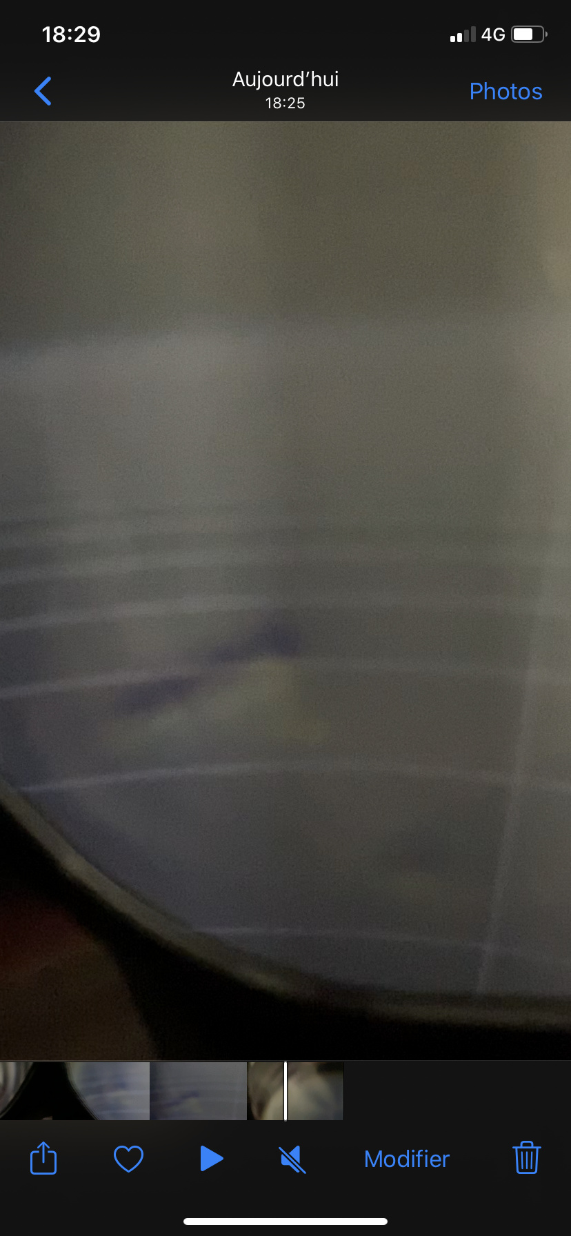

Hello guys,
I have a problem, when i look into the lenses i see a strange " Spot “, but the lens is clear, without any noticeable scratch or anything.
it happens a lot more in the right eye, and the " spot” is at the bottom left of the right lens for me, when i look into the headset…
It’s not a blank dot, or anything, the area is more contrasty, more dark actually.
I took a screenshot to share it with you, i’m sorry for the quality of the image ( PS : the whites lines are the lines in steam VR ).
Thank you for the help :smiley:
That is a bit odd looking.
Doesn’t go away with reboots or in games?
Has your headset ever been exposed to direct sunlight . It looks like some kind of screen burn .
Good point. The lens will act as magnifying glass. At least you didn’t burn the house down. (It happens.)

Unfortunately, nope, i have it since some time now, it seems that it’s more hardware i think.
That’s a nice idea.
I really dont know; i make all the possible to dont expose it to the sun, but maybe one day, for some hours when the sun moved, it has hit my headset.
i will look more for that :slight_smile:

I summit a ticket, so far they asked me to install an other firmware, but it didn’t help.
did you remove your lens?
How it can help me ? i am trying to understand.

So far i have open a ticket, they asked me to install an older firmware , i did that without any sucess so far.
I searched some pictures of VR headset lenses sunburned, but i havent found any yet to compare with my problem.
Because it can be that, but the screen is perfect, i mean it work perfect, i dont have any blank dot, or anything, its just a zone that is darker.
In game, when everything move and with more color, it’s less annoying, we barely see it.
Thanks for your comment and help :slight_smile:
Are you covered by warranty still? It may not be majorly annoying but I’d RMA if possible.

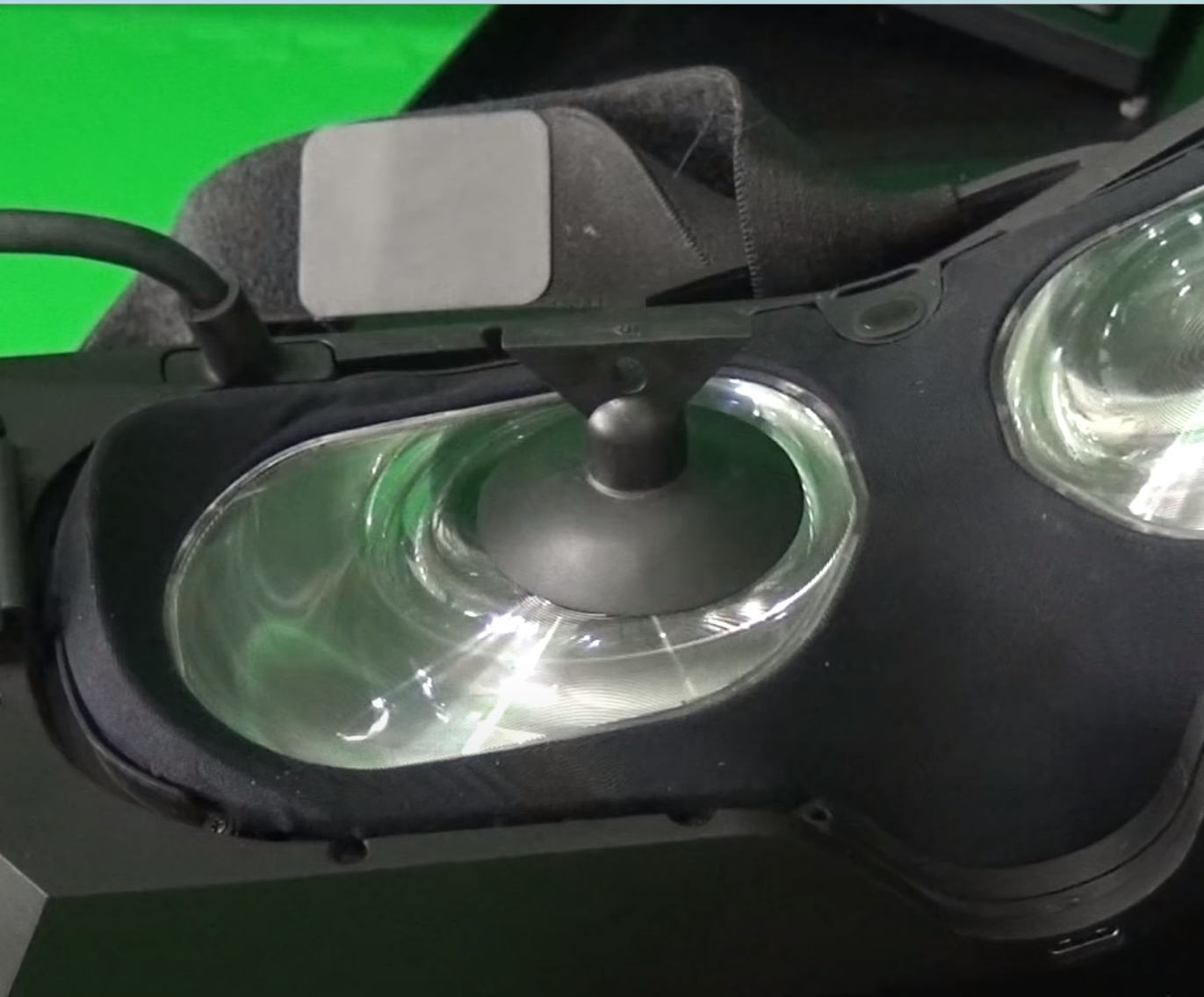

Your spot looks dark which is nice, the burn spots can be bright red and awful looking. Here’s an example. If it is a burn spot, yours is minor, and in that case I’d potentially try to ignore it haha. But It’s hard to tell how bad it is without trying myself.
and another
