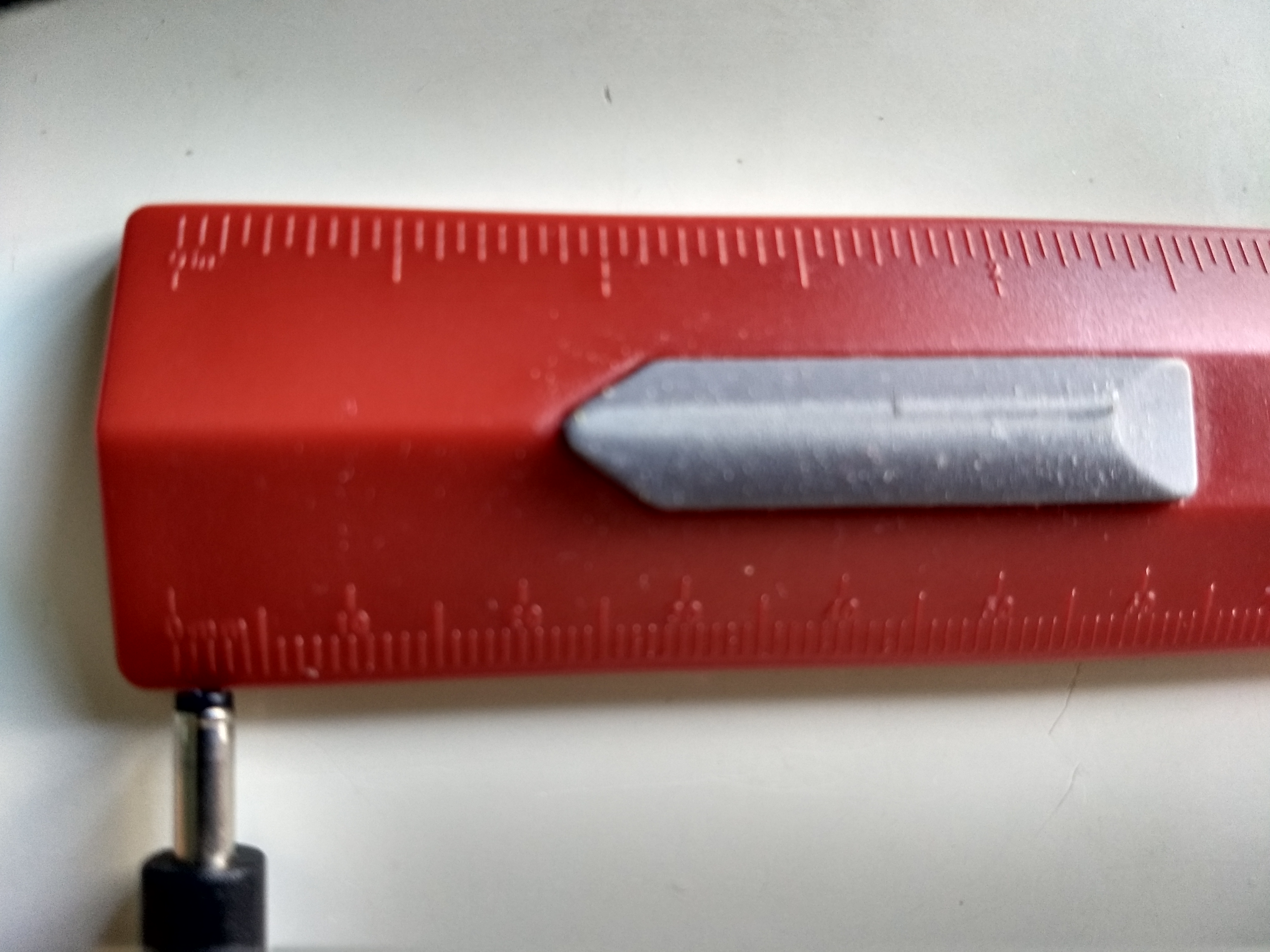

I don’t mind picking up a power adapter to test, do you know what kind?
I understand that it needs to be 12v with at least 2 amps, but do you know what size the connector needs to be to connect to the HMD cable? I’ve been having a hard time finding the exact size.
Cheers,
Josh.
Here’s some pics from my UK one for 5k+, although the connectors to the headset are presumably universal. 3mm in width.
Sorry if it’s blurry, my phone doesn’t focus too well on it
If no luck, I suggest @PimaxQuorra can help further :+1:
its a 3.5mm diameter plug
I just bought a random universal power supply.
It’s a pretty standard plug size.

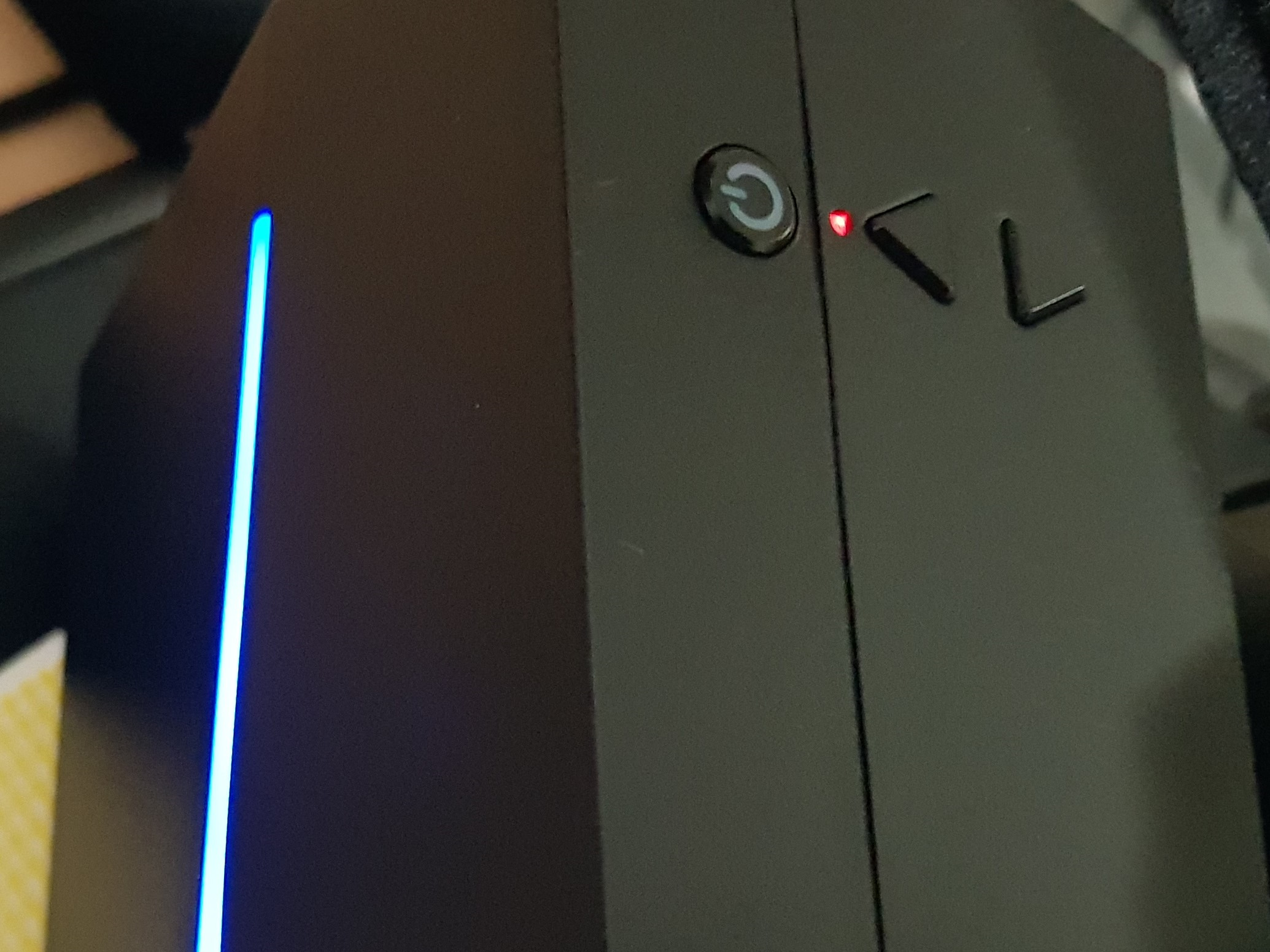

Hi All,
New power supply has come in, same issue unfortunately.
When connected to power the led will flash red once then turn off.
Here’s a quick video, this is when I plug in the power.
Headset is plugged in via usb and display port as well
Any ideas, am I missing something simple?

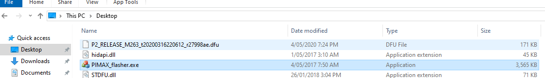

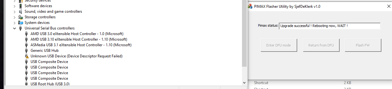

In the process however I decided to try getting the device into dfu mode via the power button combination have had some level of success there.
I have been able to get the device into dfu mode.
Using one of the flasher tools I have tried applying the newest firmware.
It “succeeded” then started rebooting which is when I received an error with the usb being unrecognised. Flasher tool still thinks it is rebooting.
Power LED is now a solid red (progress at least!)
I will wait a little longer in case it’s a time thing before trying again.
Might also try another usb port as well, as suggested.
Cheers,
Josh.
Different method, says success still but headset now stuck with a solid red LED and 10500 error.
Tried both the latest manual firmware and the firmware from Pitool p2.dfu.
